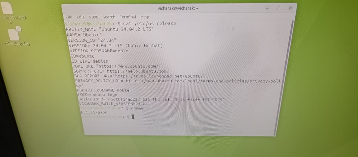

Here is the output for the following:
cat /etc/os-release and uname -r
Since i have tried to run this video
