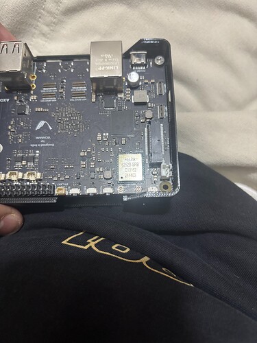

After getting wifi chip replaced. my axon is not discovering 5 GHz band. only 2.4 GHz working. what could be issue?

It is axon onboard chip and original antenna came with box

Make sure you have connected antenna o WiFi U,FL Connector.
Yes antenna is connected correctly in place. but still same problem

I connected two different antenna. those are new came with box. but still no 5GHz connection. is it possible that antenna port on board may damage?
Send board photo, make sure UFL connectors are clearly be seen
