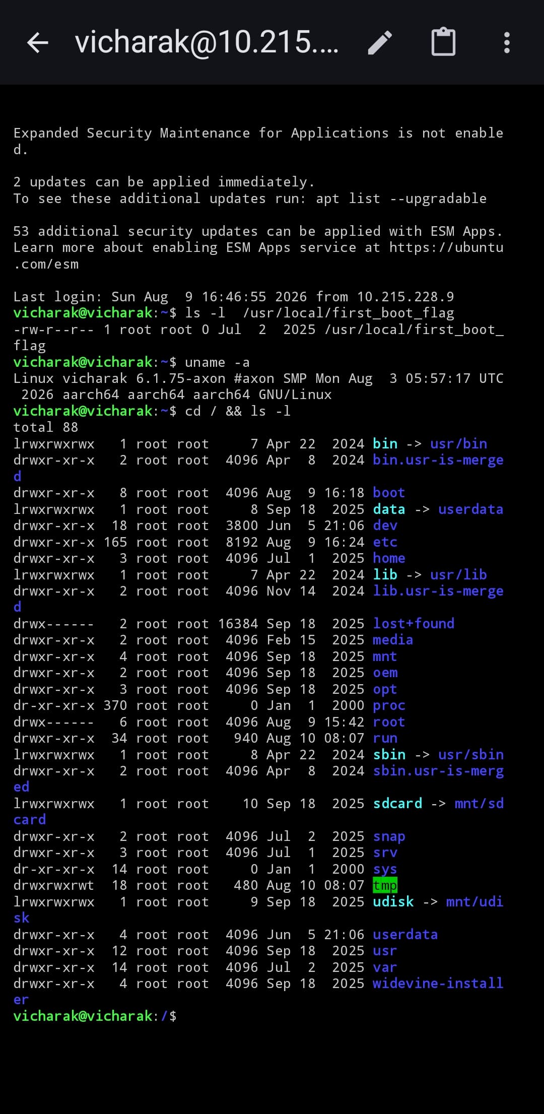

Could you send the output of below command !?
ls -l  /usr/local/first_boot_flag
uname -a
cd / && ls -l
icharak@vicharak:~$ ls -l /usr/local/first_boot_flag
-rw-r–r-- 1 root root 0 Jul 2 2025 /usr/local/first_boot_
flag
vicharak@vicharak:~$ uname -a
Linux vicharak 6.1.75-axon axon SMP Mon Aug 3 05:57:17 UTC
2026 aarch64 aarch64 aarch64 GNU/Linux
vicharak@vicharak:~$ cd / && ls -l

vicharak@vicharak:/$

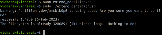

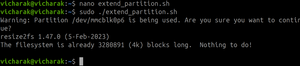

Could you run below script and sent the output !?
extend_partition.sh (423 Bytes)
  1. Download it.
  2. sudo chmod +x extend_partition.sh
  3. sudo extend_partition.sh
