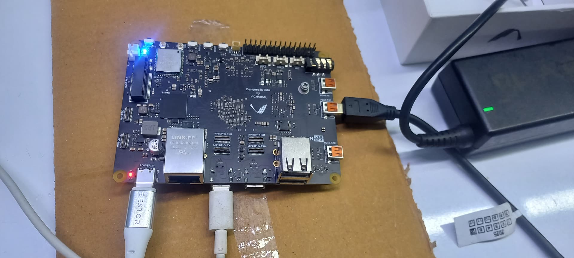

When connected to the desktop, it booted up fine initially. I accessed the controller and installed coding programs. But yesterday afternoon, the desktop suddenly went blank. We didn’t make any changes. We tried continuously booting and pressed the reset button twice to get it into Maskroom, but nothing worked.

  1. HDMI is connected to which port !?
    HDMI0 or HDMI1
  2. What is the status of LED !? Is it blinking or stable !?
To check whether the device is in MaskRom, make sure the Type-C Cable is connected to the to the Type-C0 port.
It is in maskroom only one light is tirned on and i have connected the cable to the laptop theough usb to c in type co
Now, does it detect in Maskrom !?
Again Make sure you have installed usb driver in the host pc as mentioned in the documentation.

How to know does it detect?
I have connected the axon to the laptop only how do i know that it is in maskroom?
How to install usb driver?
Have you gone through the above links!?
You will get all information in detail.
Yes it’s cleared now thank you
