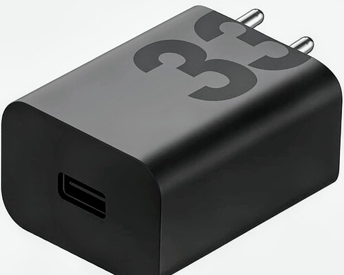

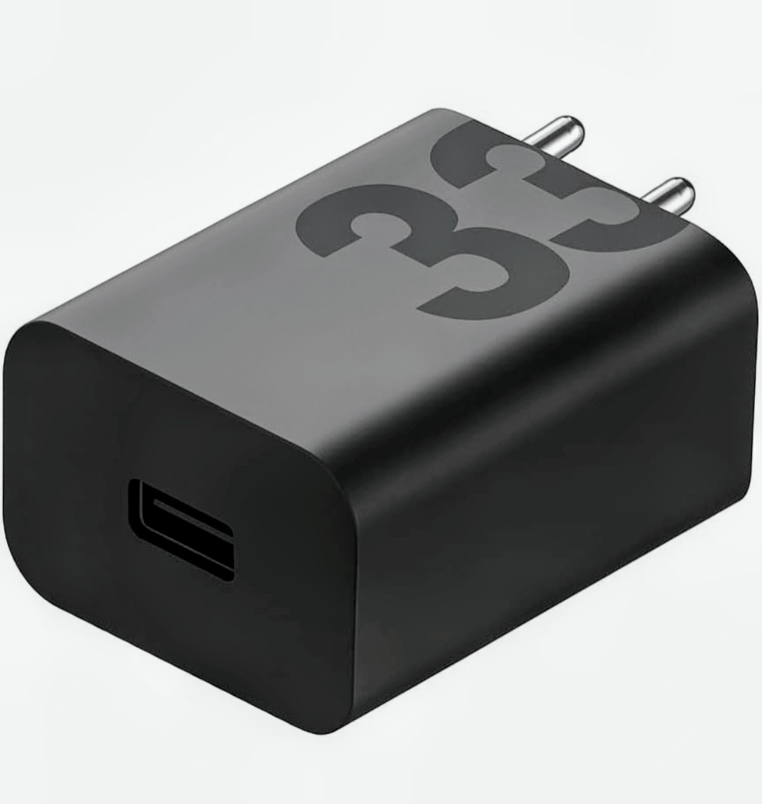

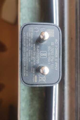

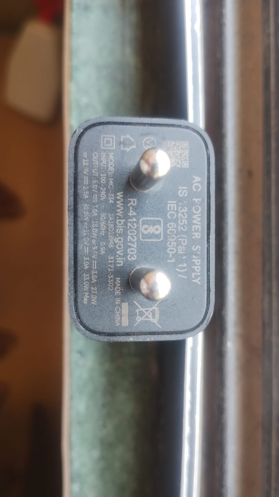

:battery: My Charger Info: The adapter I’m using is a Motorola TurboPower 33W Charger (Model: MC-334)
  • Output:
    • 5.0V ⎓ 3A — 15.0W
    • 9.0V ⎓ 3A — 27.0W
    • 12.0V ⎓ 2.5A — 30.0W
    • 11.0V ⎓ 3.0A — 33.0W Max
  • Protocol: Qualcomm Quick Charge (QC 3.0) (not USB PD)
  • Connector: USB Type-A
:camera_flash: Image of Mobile Adapter :

I tested my non-PD adapter (Motorola TurboPower 33W) by adding multiple peripherals and load — the Axon became unstable and rebooted unexpectedly. This confirms the power limitation. So, I got that is better to switch to a proper 12V adapter with PD Protocol.
