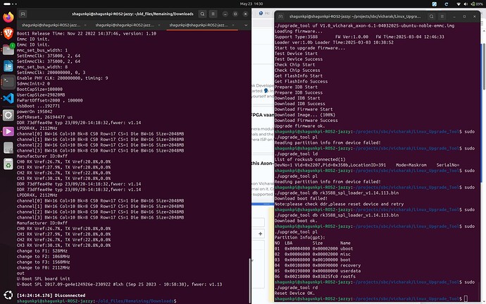

Booting issue not starting up
please see the series of actions i have performed.
and also any suggestions for what dc-dc buck converter should i use for powering axon with 24 v battery

I already did that but the boot stuck at uboot SPL always i have shared an video i am sharing the link here as well for your reference
Screencast from 2026-05-23 14-16-18.webm
Not able to open, sent request as well

no akshar it did not boot successfully into the OS and i am using axon board
