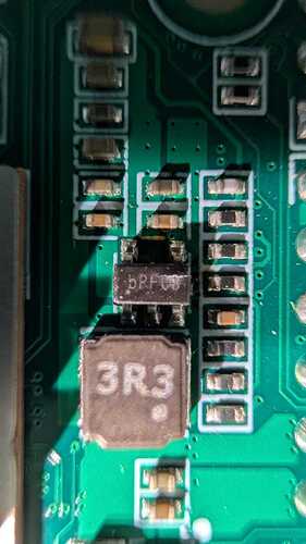

I have a vicharak vaaman board. While using the board one the componets got damaged. It’s a small 6pin IC next to a 3R3 module I think the marking on this module is 5PFCB. I want to know which component is this exactly. Also to what extent can this damange the Vaaman board. What steps can i take next to get this issue sorted. Can i get the schematic of this board to deduce what other components and module could be affcted by this damaged part.

From the photo you sent, all the outputs of that part go directly to the processor and are not used anywhere else. Therefore, the possibility of this IC getting damaged is very low.
What were you doing when this IC got damaged? It is unusual for this IC to fail under normal operating conditions.
Also, please do not power on the board until this IC has been replaced. Doing so may cause further damage to the board or other components.
I was powering on when smoke started coming out of this IC I immediately removed the power and raised this topic. Also can I know what exactly is this componet and where to get it to replacec it form the board?
As, discussed internally with you. We will help you with replacement of the part.

Could you please let me know how we should proceed from here? If the replacement is to be carried out by me, could you share the exact part details and the process for obtaining the replacement component?
If the replacement is to be handled by your team, please let me know the next steps, including any shipping or RMA procedure that I need to follow.
Thank you for your assistance.
Please share the reference for this case by emailing support@vicharak.in Our support team will provide the shipping details for where the board needs to be sent.
Once we receive your email, we’ll assist you with the next steps.
