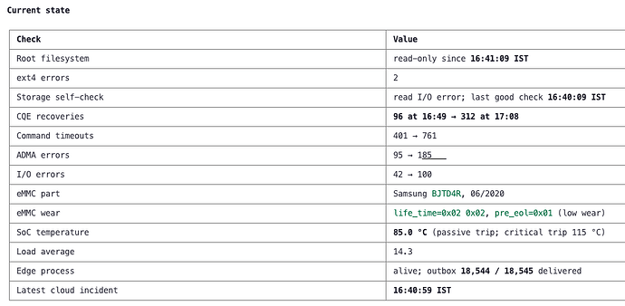

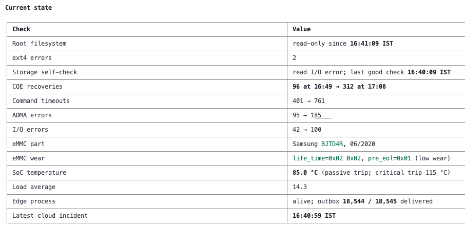

eMMC has a hardware fault
Device is now unable to connect to internet
Root filesystem read-only (ro)
ext4 error count 7
Storage self-check write stalled 184.3 s, then I/O error
Storage controller resets 742
Storage errors 740
I/O errors 347
Last kernel line mmc0: cqhci: Failed to halt
From another device, we can access this remotely
