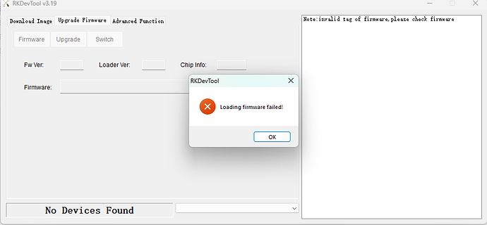

on trying to flash raw image how to fix
Kindly Go through documentation.
https://docs.vicharak.in/vicharak_sbcs/axon/axon-linux/linux-usage-guide/windows-rkdevtool/#flash-raw-image-in-emmc-to-axon-board

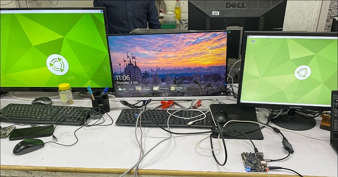

Hey @Namitjain07 , I tried creating the same conditions which you described, in multiple boards, but I am not able to recreate the same issue.
Please share the pictures of your setup, which includes the connectors and cables you are using, closeups of board. And info about the display you are using.
