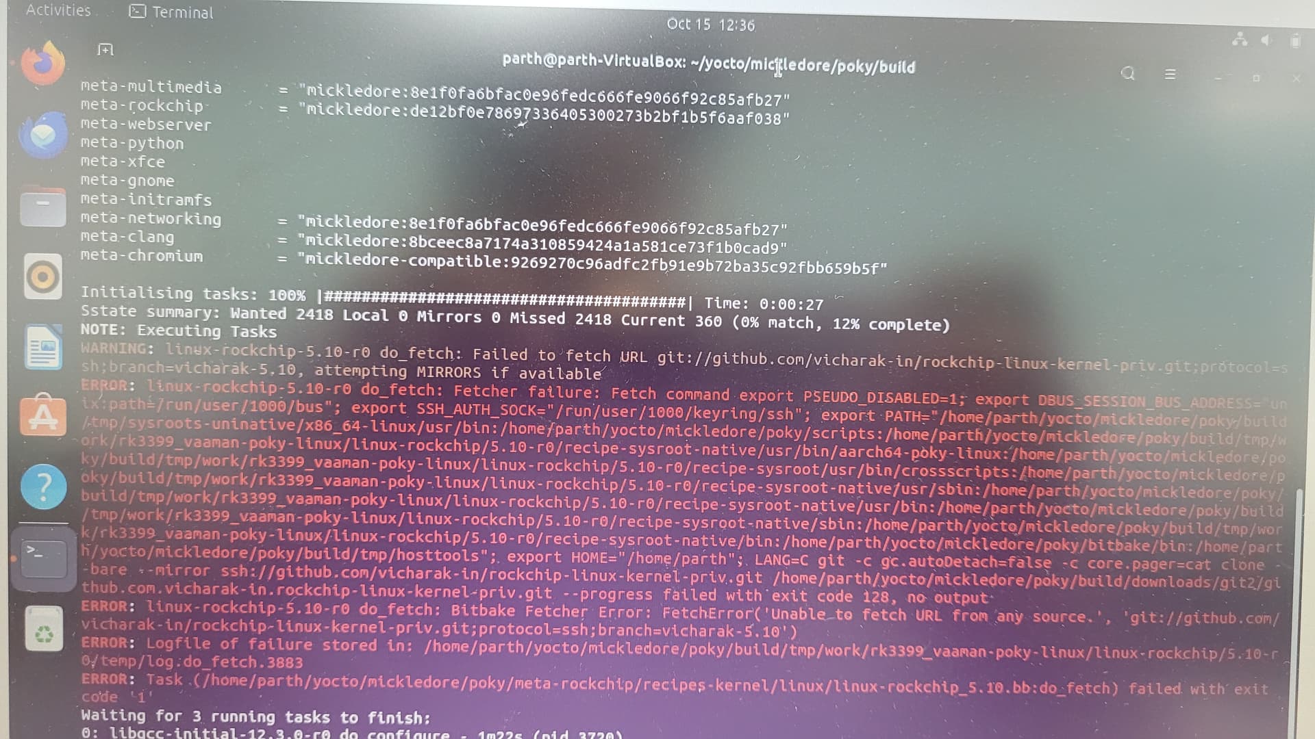

Hello team, I've getting this error while I am doing the yocto image for my Vicharak board When I tried with HTTPS i got not found, where I have another option to go with SSH, so what should I do?
Try to clone this Kernel Repo.
We will correct.
I have corrected it.
Just go to meta-rockchip folder.
Update the branch by running command below.
git fetch
git fetch <remote-name> <branch-name>
