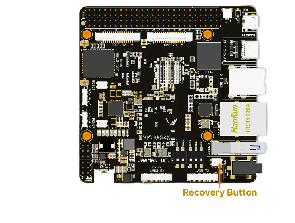

- Press Recovery Key for 4-5 seconds located at nearby 3.5 mm Audio Jack which turn on Vaaman’s internal hotspot with ip
10.9.8.7
Now, You can find
VaamanHostWiFi in another device that can be mobile or laptop. ( WiFi Password :12345678) -

@Avi_Shihora
I sucessfully got into the recovery mode but on ssh i am getting below response
ssh: connect to host 10.9.8.7 port 22: Connection refused
I hope, you are connected to VaamanHost Wifi.
Yes I am connected to VaamanHost
There might be a chance, that Vaaman’s internal ssh service is not active properly.
Try first to restart the board,
Then when you get blinked blue lights on Vaaman, after a few seconds,
Again Press the recovery button to turn on the hotspot.
Still, it does not work, We recommend flashinga new image.
