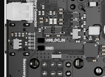

Also regarding the Supply in Axon lite
Are there any pads available to supply power to board other then C type supply?
You can use the battery connector for the purpose of direct DC supply, but DO NOT pump above 4.1-4.2 volts into it.
What if we want to power up board via 12 V DC SMPS
You can solder the 12V input here if you have the equipment
USB_DC_IN will be marked as “+” and GND as “-” on the actual board
