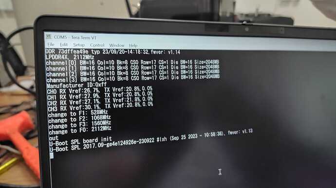

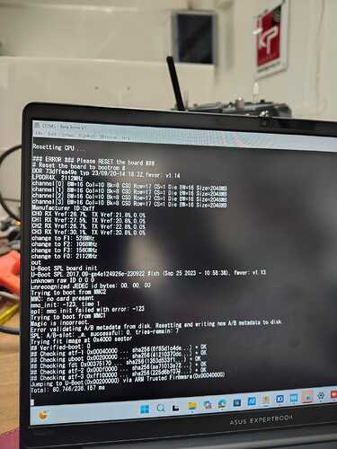

I have axon board which was working for several days. But I am trying to start it from yesterday, but it is not working. White light is not blinking as it should. Image downloads perfectly.

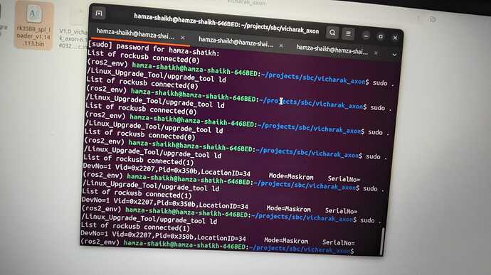

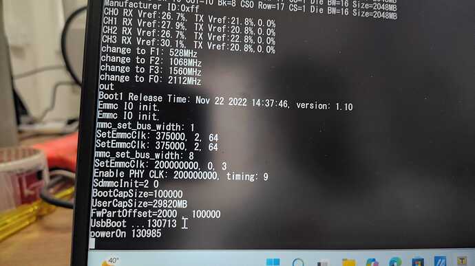

It seems you’re only downloading u-boot. you’ll need to download whole image alongside with u-boot images.
Kindly, run another mentioned command.
If you have donwloaded eMMC image than, run below command.
sudo upgrade_tool uf  <*.img>
Follow these guide for more info
