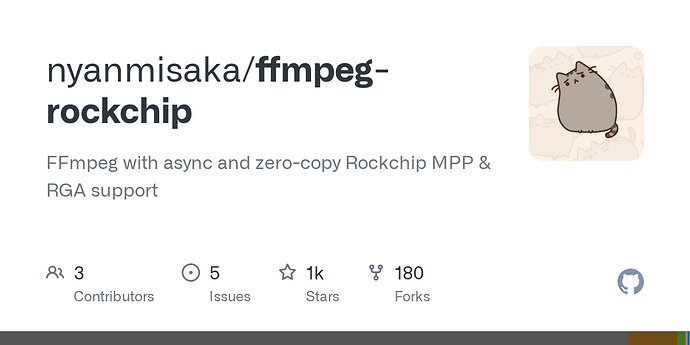

We were working with this GitHub repository to use hardware decoders on the Axon Board (Rockchip 3588). However, this repository no longer exists due to a DMCA report filed by FFmpeg, and it has officially been taken down. Are there any alternatives to this repository that would allow us to build FFmpeg to use h264_rkmpp?

Yea we tried with that, and its working for our use case. Thank you so much @djkabutar & @Avi_Shihora
