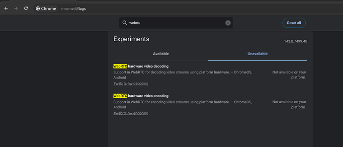

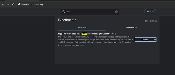

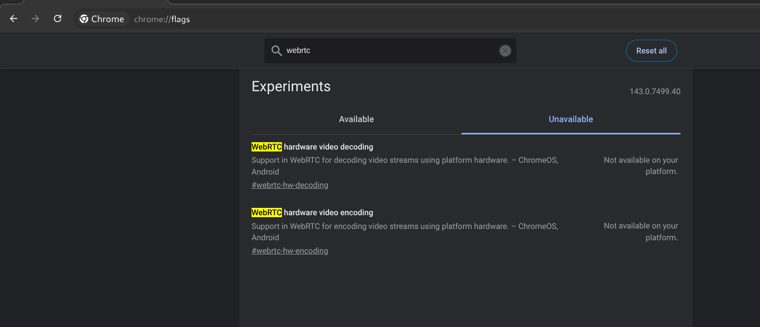

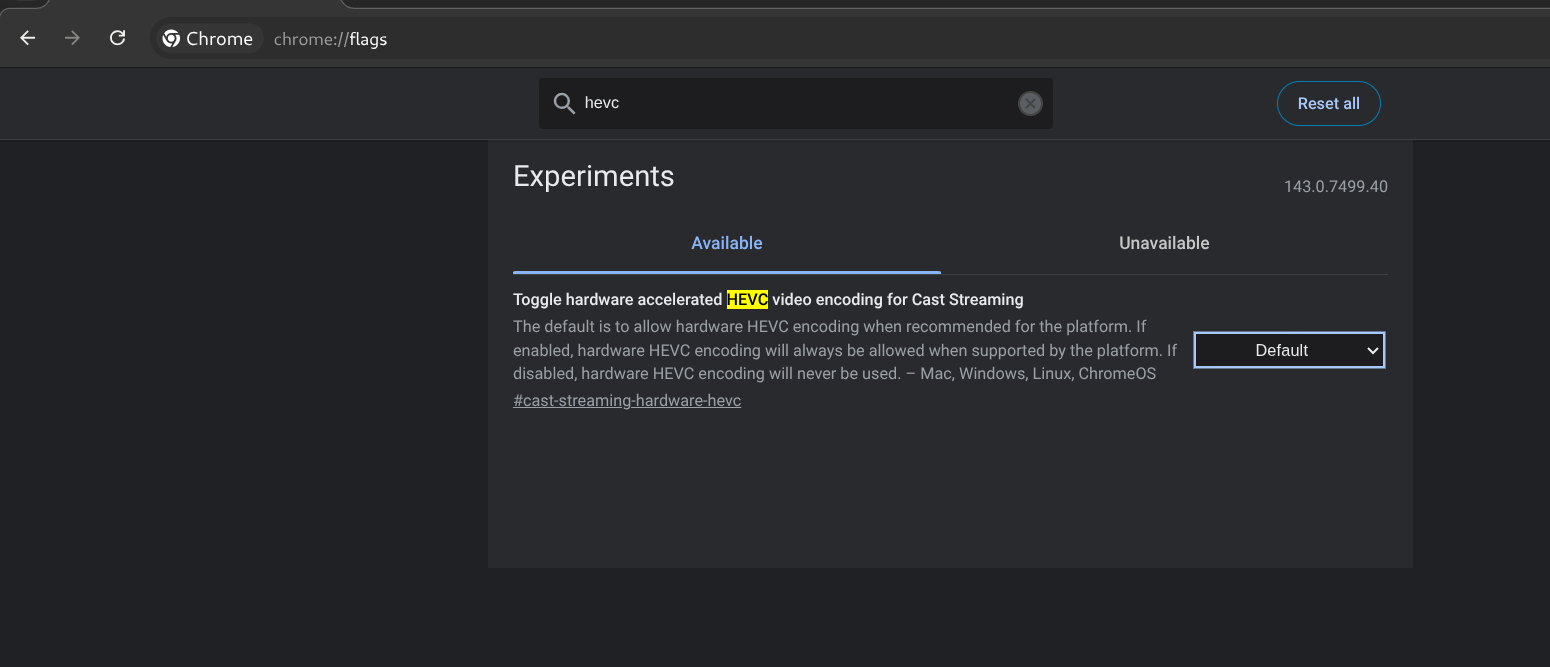

And based on our research, Chromium 114 does not include any experimental flags related to enabling HEVC (H.265) decoding in WebRTC. Also, Chromium v127+ only supports H.265 encoding, not decoding. The WebRTC HEVC flags are available only on ChromeOS and Android, here is screenshot of it.
