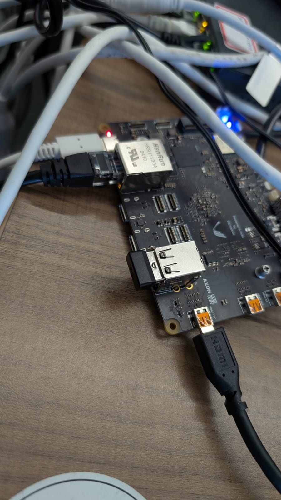

We had left Axon board on with our wireless Logitech keyboard and mouse connector plugged in on Saturday evening. On Monday morning (today), neither USB slot is functioning with any other mouse/keyboard (however, it is detecting pendrives). The keyboard and mouse have malfunctioned and are not working with any other computer. What could have been the issue?
