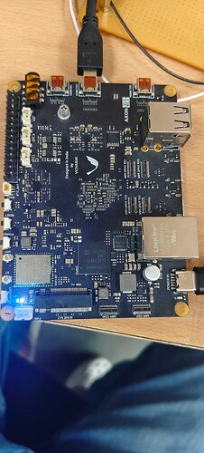

Hi, I have been using vicharak Axon from last 2 weeks and while doing process all of a sudden, it stopped working.
The red LED is not powered up only white/blue LED is working.
Attaching image for reference.
The vicharak Axon was running on 12V supply and i was using KiCad to design our PCB and test the RKNN openCV model.
Please kindly help,

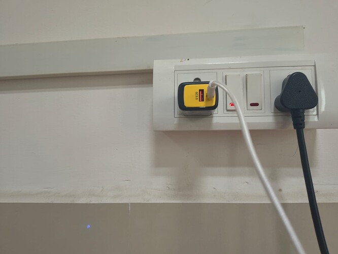

attaching a full video for the plug-in test we have conducted.
It seems you’re powering it wrong.
Axon requires specific type-C PD cable. Plus PD adapter with 12V support.
Read thru our documentation once.

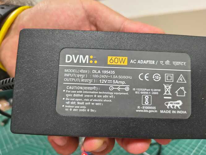

We are already powering it with 12V PD Adapter.
Kindly note. It requires specifically 12V PD adapter, not this one.
We also have put 12V PD adapter link in our documentation.
Use the cable that we shipped with box and 12V PD adapter and let us know.

The product is currently showing as out of stock on our website. However, you can use this Pd adapter as an alternative :-
https://www.zepto.com/pn/nu-republic-cybotron-45w-dual-port-gan-superfast-wall-charger-usb-type-c-port-qc-pd-technology-with-type-c-to-c-cable-supports-macbook-type-c-laptops-iphone-samsung-oneplus-etc-black/pvid/1b813b14-6b04-4bec-ba46-406a15e22ea9
Regarding the power supply, the USB Type-C port is intended only for power input using a USB Type-C PD adapter, as mentioned in our documentation.

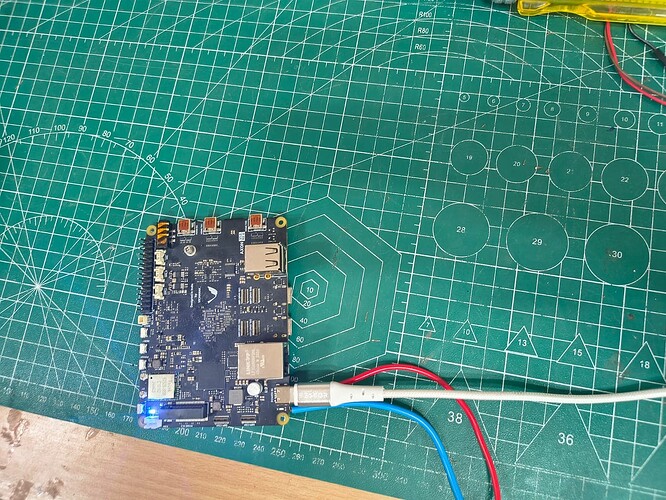

Hi Team, We used the same PD adapter that you recommended but still not working.
also we tried to power it with LFP battery with constant 12v at dedicated power pads but still no power response.

While powering up a device, with those black and red wires, there’s a possibility that device may have been damaged due to inverse polarities.
