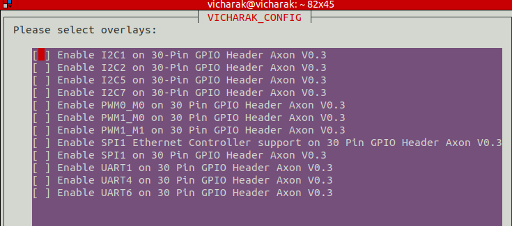

I recently installed the Ubuntu 22 Server (Beta) image and noticed that in vicharak-config, there are no options related to camera overlays.
I’m using a Raspberry Pi Camera Module V1, and previously on the desktop version, camera overlays were available.
Is this a known limitation in the server beta image?
How can I enable camera support on this version?
Would appreciate guidance on using the camera module in this setup.
Thanks!
Yes, in Beta-image, we have not provided camera overlays on it.
But you can get access to overlays. We will make it available in the kernel soon.
So, just updating the kernel, the overlay will be placed on system.
