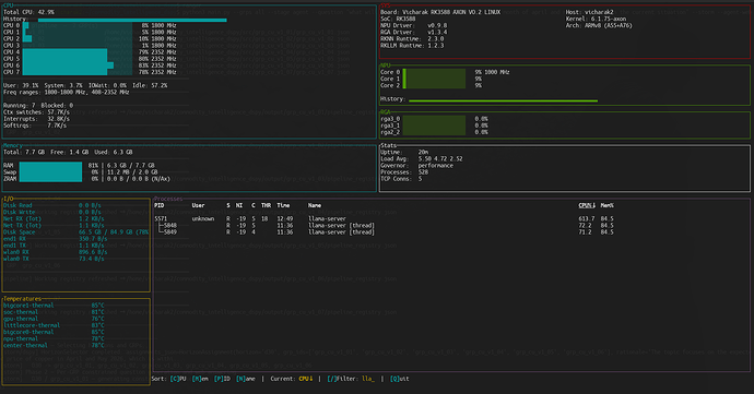

can someone help me figure out what i am missing?I tried running gemma4 e2b on the axon using rk-llama.cpp and it loaded perfectly fine. but the npu has never utilized to its fullest. I tried changing the governor to performance and change the clock speed to max, but it still remain the same as before. Is it normal with axon or am i missing anything important?

Also as far as I have gone through the code, they are delegating the matmul and vector operations to NPU via rknnrt, rknnmrt & rkllmrt and for rest using llama.cpp cpu backend, so there might be too many memcpy and cross platform procedure call overheads. And due to this utilizing NPU at full is not possible.

I am trying it now, using rknn runtime version 2.4.3 and rkllm runtime version 1.2.3. and gcc-13. And set ddr frequency to max, and running gemma4 e2B, it is utilizing 22% NPU across all cores.

My current RKNN version is 2.3.0 and RKLLM is 1.2.3. with these i was able to attain max 20% utilization. But is there a way to go beyond 50 or 60% min? So far i was getting ~4 Tps with qwen3 4B and 8 Tps with gemma4 e2b. If i can use 60% then it will drastically improve the performance. Am i right? Correct me if i’m wrong.
using rkllm-toolkit would certainly increase the TPS. Also the benchmark they are sharing using llama.cpp, is using lpddr5 16/32 GB ram which can run on 3.2GHz, while the RAM we have runs on 2.1GHz, so they are benchmarking on 50% faster RAM and in LLMs RAM bandwidth is the bottleneck.
