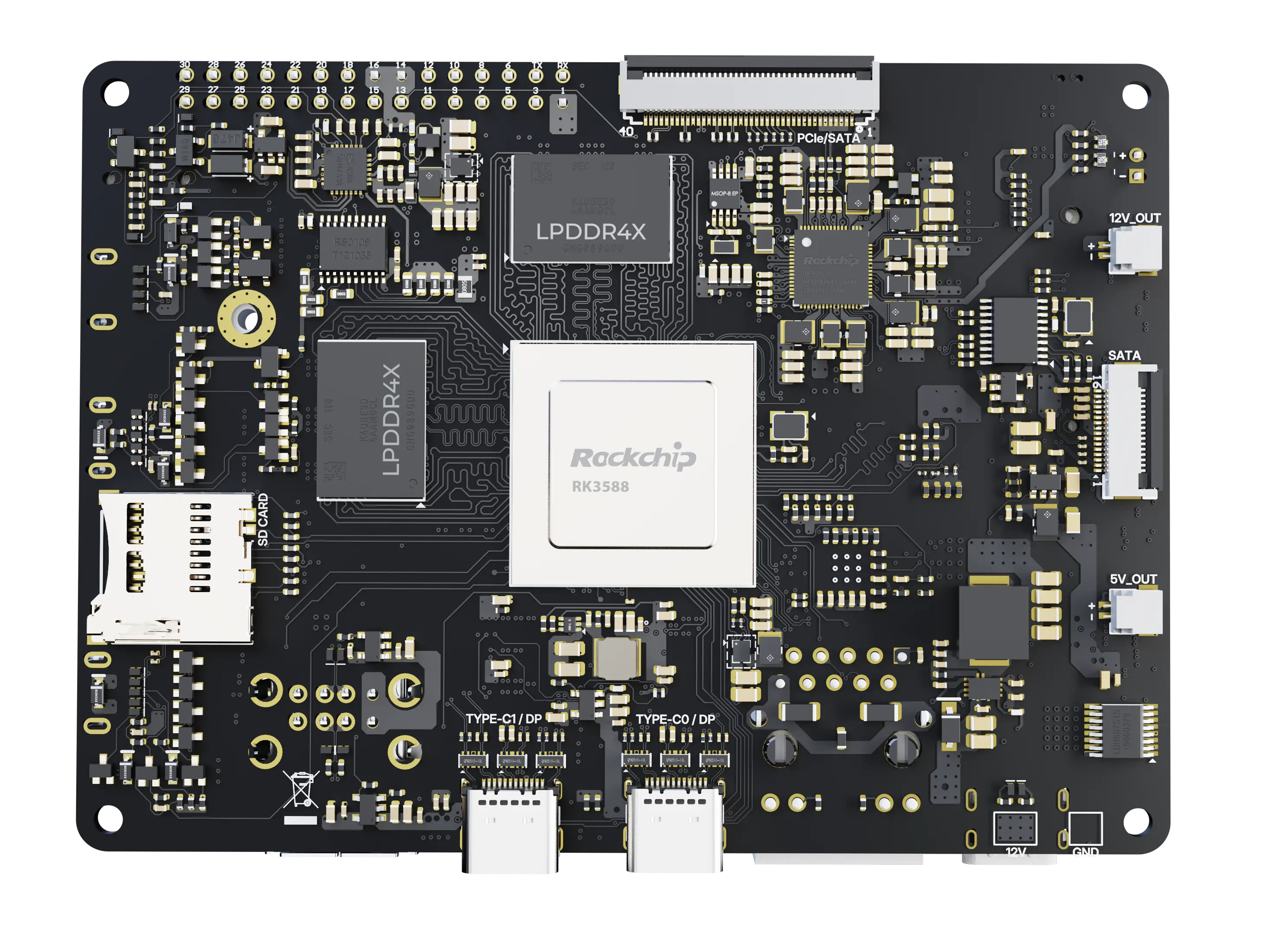

We want to power the Axon board with medical grade SMPS, normally medical grade SMPS are available with 2.54 or 3.96 mm pitch connector only. Please suggest some solution for this
@Pratik will guide you on this.
Use 12V power supply and find below pads in bottom of Axon to directly plug in those.
Look at Right corner bottom Side of the Axon.
Can i use this SMPS to power axon?
https://www.amazon.in/dp/B09577WMTC?th=1
Yes, this will work, but I would recommend using a PD adapter instead of this, as it would be a better option.
