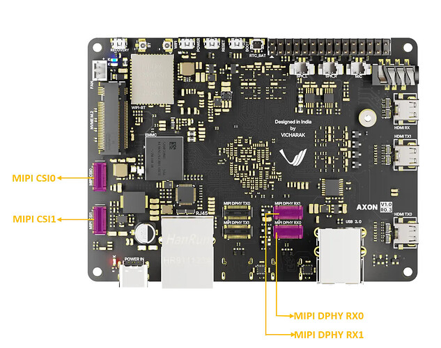

I want to connect axon board with raspi v2 8mp camera. I have the camera, axon board and 15 to 15 pin , 15 to 20 pin connector ribbon which i used to connect the same camera with raspberry pi 4b. How can i connect this camera to axon board and what are the things i should arrnage additionally which will support with axon board
@aacha, Follow this guide
https://docs.vicharak.in/vicharak_sbcs/axon/axon-accessories/accessory-raspi-cam/
You just have to apply overlays that support IMX219 as used in Raspi V2 according to connector used by you.
Pre-Requisites
Vicharak Flex Cable 30 Pin 0.4mm Pitch Cable (Golden Color)
FPC50 15 Pin 1mm Pitch Cable
Connector
