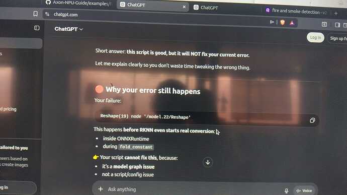

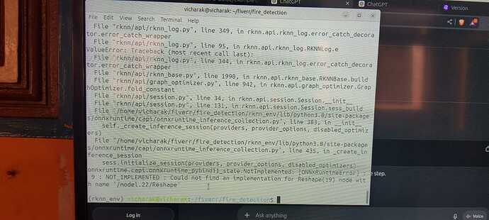

Reshape Issue , Im facing this error while converting onnx to rknn format, how to solve this ? Im using trained yolov8 model initially. In order to use it in NPU im doing through this approach
Im facing this error while converting onnx to rknn format, how to solve this ? Im using trained yolov8 model initially. In order to use it in NPU im doing through this approach.

Chat GPT suggest it is not related to my issue for the example code you sent. What is the possible way to solve this error ?

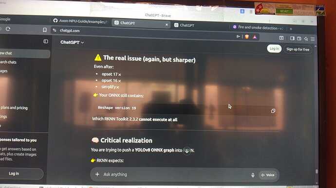

Actually im getting the same reshape error even i changed to opset 16 and opset 17. Chatgpt says to use yolov5 to avoid header issue but i have only yolov8 model. give me possible way to solve this issue.
ChatGPT says itmy error is not related to code, it is related to Graphics. so this code which you shared wont suites in my case
It is the issue in the export of model, so it is not related to some graphics issue.

I tried all possible ways i can’t solve this resizing error. could you please assist me
So far i have created lot of onnx files but still the result is zero. because of yolov5’s accuracy i cannot use it. kindly help me to solve this issue and run the model for detection.

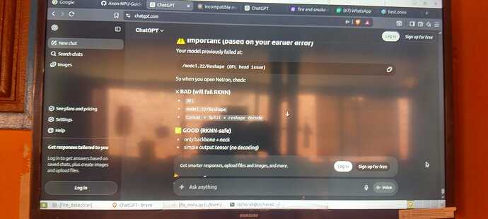

you need to remove the DFL layers - specifically the post processing layers from the model (look at DFL head issue) and then try converting and perform inference. thats what we have basically followed. you can find the script to remove nodes in the links previously provided in the Axon-NPU-Guide or use onnx-modifier to remove those nodes via a GUI

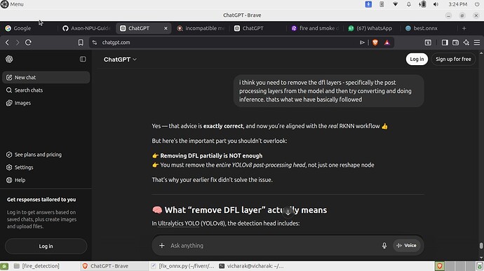

Hi @Thiru what chatgpt’s response is saying is that You must remove the entire YOLOv8 post-processing head, not just one reshape node , which is what exactly done in the code mentioned by @riddhi_raj and he had already tested it and that worked for many custom train yolov8 as well as yolo11 models. So that would work.
Besides, AI models are not fully aware of the environment and they don’t have much data, while training, on what actually works. So, it doesn’t always help while debugging for specific hardware like NPUs.
Let me briefly explain again what’s actually happening and what is the actual fix.
YOLOv8 models uses distributed focal loss (dfl) for predicting bounding boxes’ coordinates. This basically calculates the expected value of height/ width / centres from probabilities of it having different values (total 16 values having different probabilities) and calculating this final co-ordinates requires various reshape, softmax, scale, concat, etc operations (which can be easily done on CPU at better speed). Now, after this model produces a single output of shape (1, 84, 8400) (it may change based on number of your classes and input feature shape). What you have to do it is to remove that last processing layer and so there will be 6 output nodes and later you can perform that processing on CPU. And this will surely work because RKNN toolkit parses the graph topologically and since it has reached that reshape node so all nodes before it is already correct and can be parsed. It is a tested working way and you can follow it to obtain a convertible onnx model and then you can convert that. If anything is unclear, please ask!
