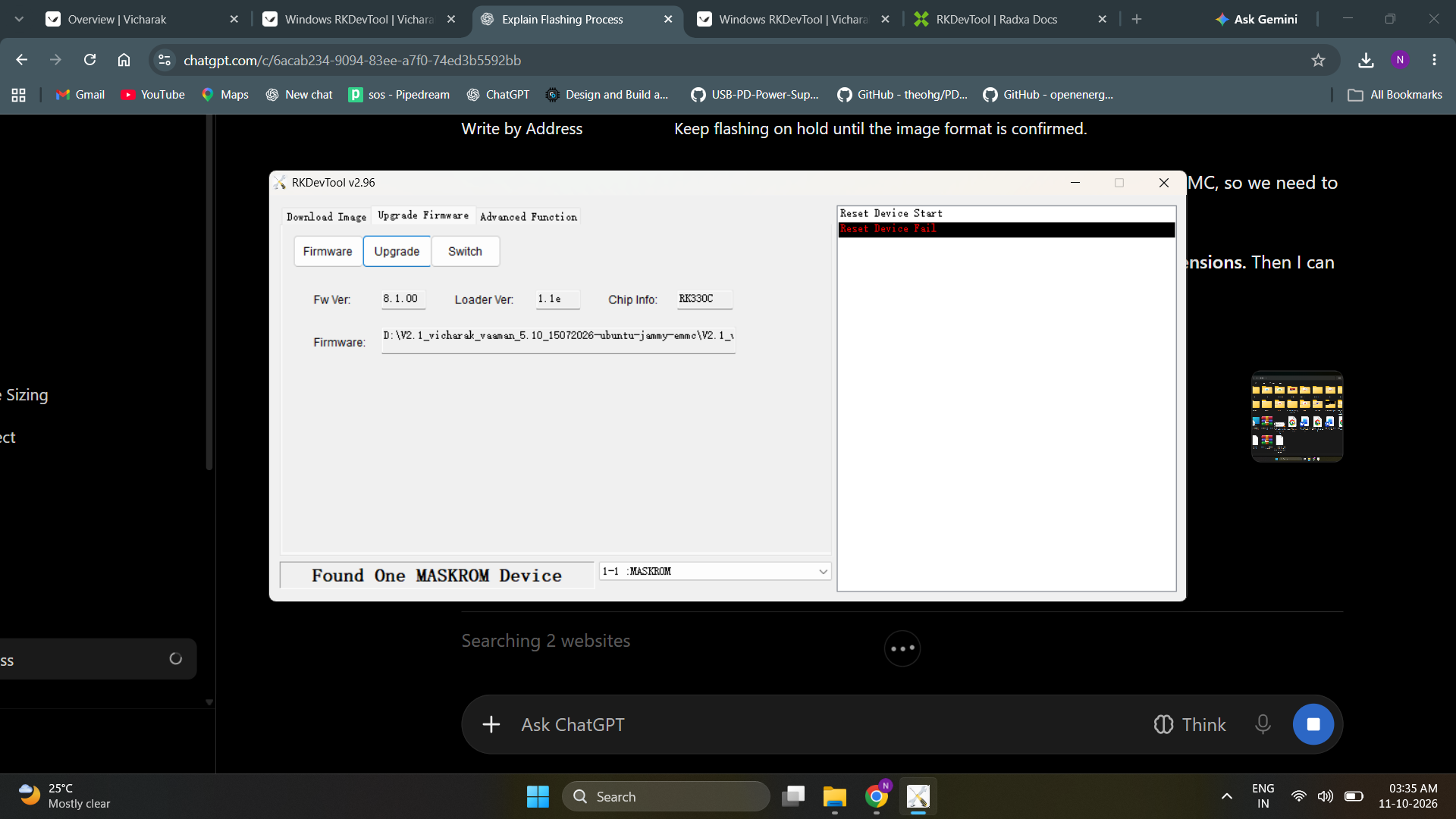

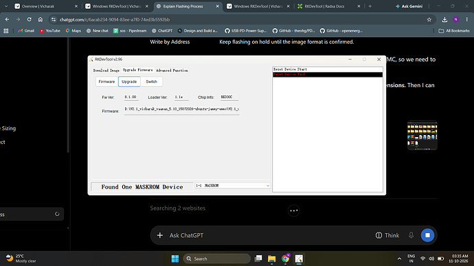

Above is the image when i am trying to flash ubuntu file downloaded from vicharak git library.

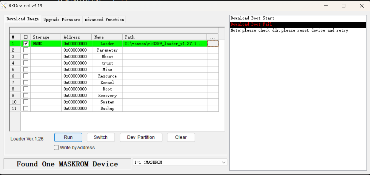

Above is the image when i am trying to flash loader file it shows ddr error.

There might me issue in RAM/eMMC.
