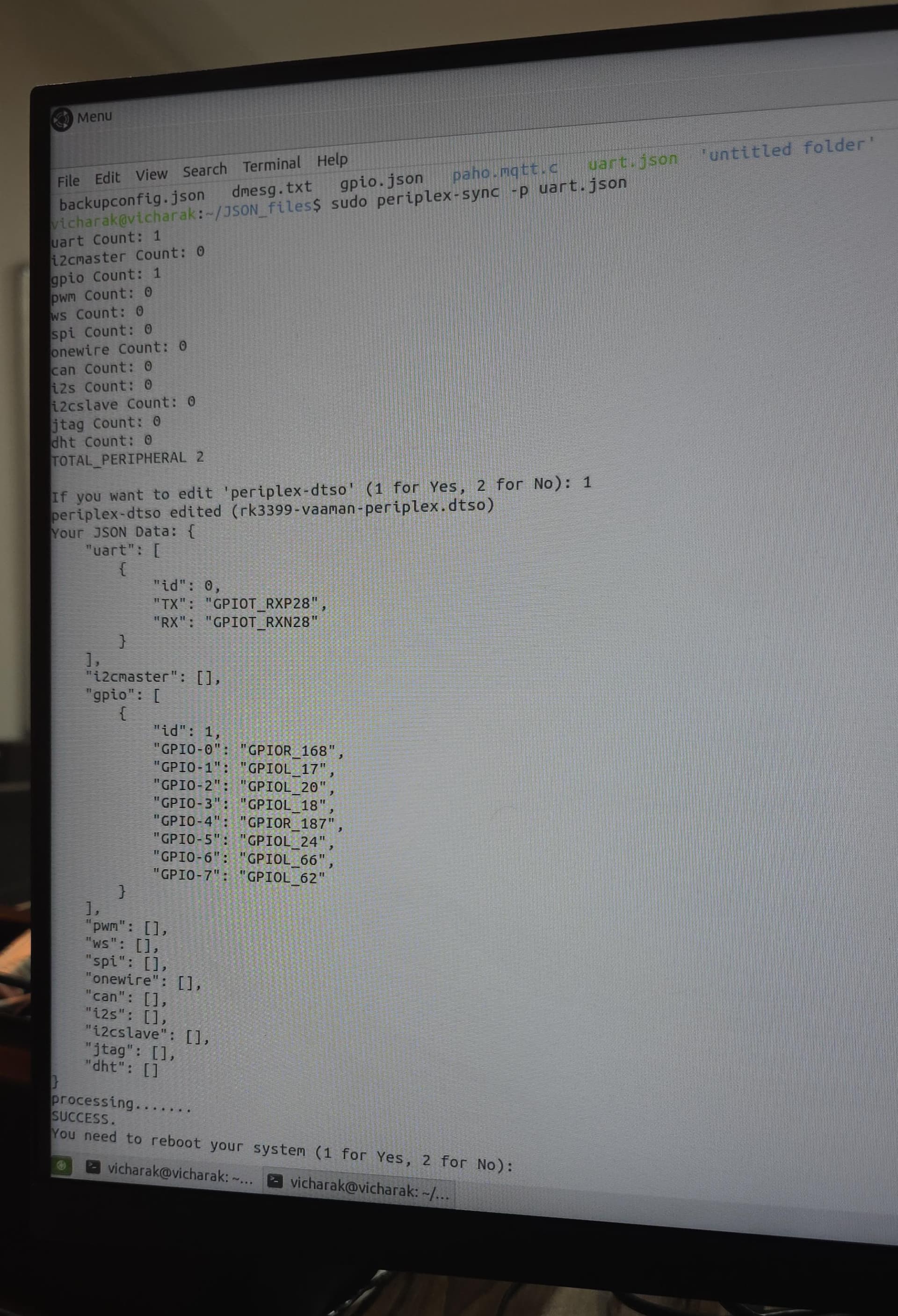

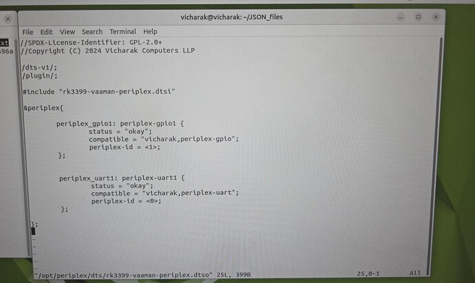

okayy run the periplex-sync command now for the same json.
Please reboot the system and verify once again. Let me know whether VAAMAN is receiving any data, regardless of the byte count. If no data is received on VAAMAN, we will need to reproduce the same scenario on our side

checking with new JSON file
its not working

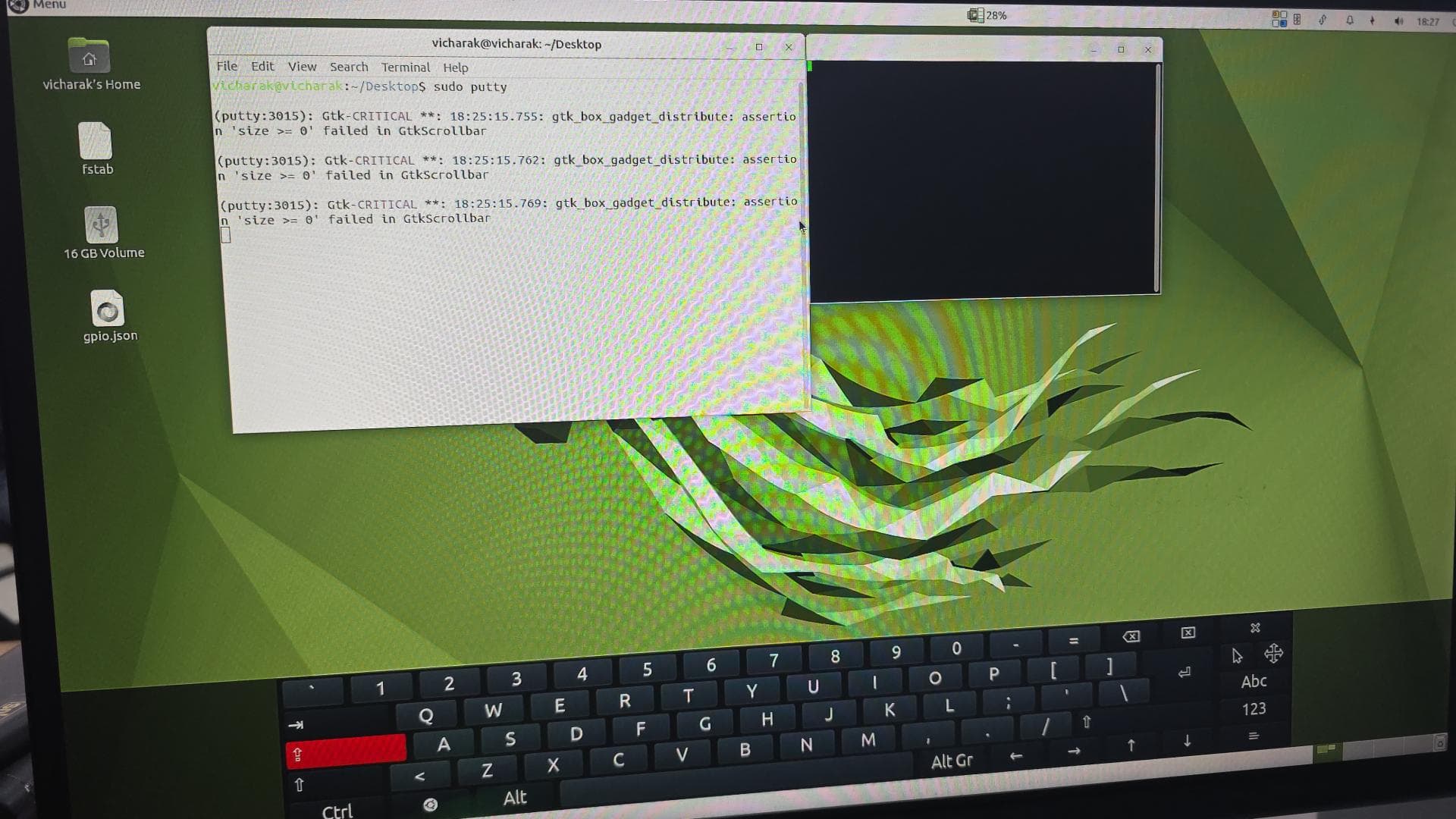

yes write , i am using putty with baud rate 9600
In that case, this appears to be a different issue rather than a UART issue. If VAAMAN is not receiving any bytes at all, it may be related to the hardware or the connection, because 22,000 bytes per minute is a very small data rate. Please also check the wiring.
