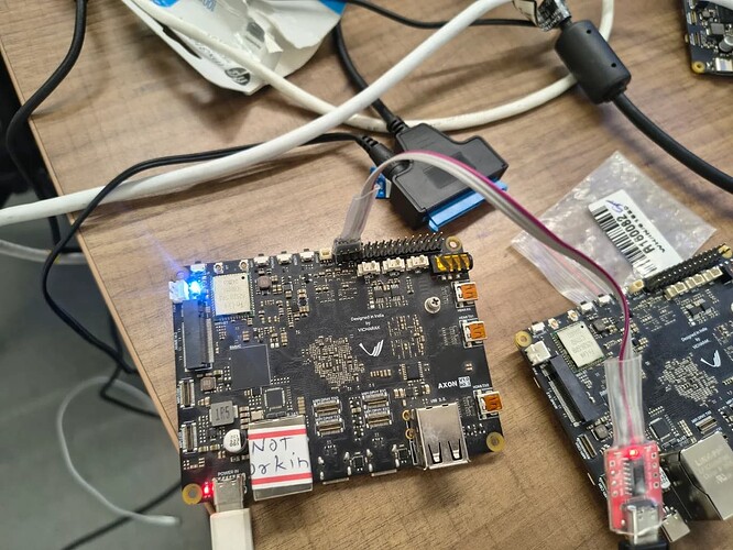

One of my Vicharak Axon board is not booting properly . so i tried to connect it via serial console. and these logs i am seeing can you guys help with this ?

Issue is in DRAM that you are facing.
so what should i do now ?
@Rajat-Pathak will guide you on this.
Can you try flashing new image on this?
already tried flashing it failed on both the boards.
hey actually our work is getting delayed and stuck due to this issue. can you guys please guide further on how to proceed or fix this ? if not then what can I about this ?
