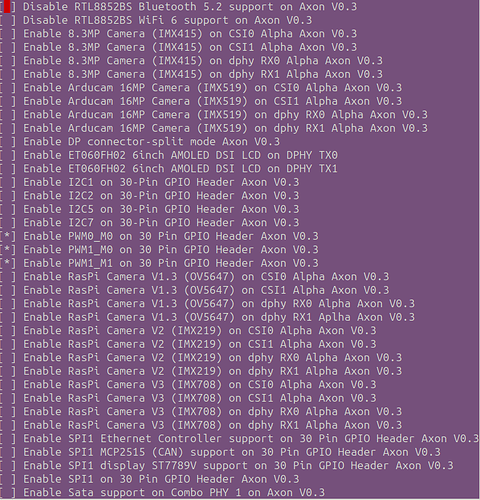

What are the overlays you have enabled to use PWM !?
I have attached screen shot of overlays.
Don’t turn overlays named as PWM1_M0 and PWM1_M1 simultaneously.
For your case, Due to Muxing mechanism of PWM0_M0 and PMW1_M0 OR PWM1_M1.
You can only run total two PWM simultaneously.

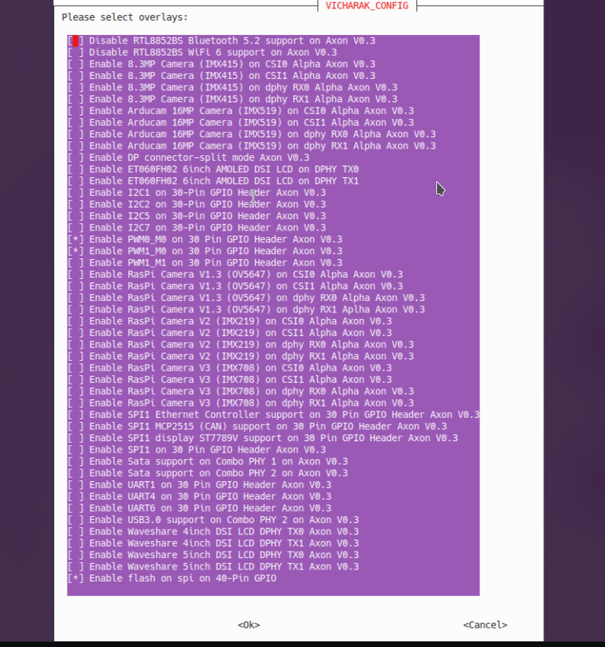

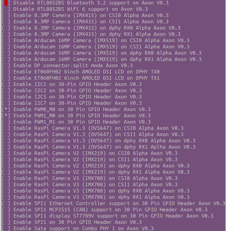

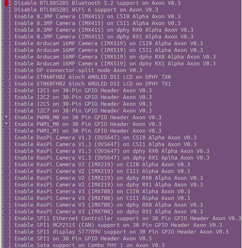

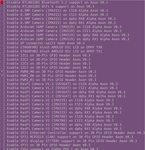

Could you please share your Overlays Configuration menu, similar to the screenshot below? I’d like to verify that no other overlays are enabled.
Based on the dmesg log you shared, it appears that GPIO0–GPIO15 are already being used by other peripherals. I want to confirm that no additional overlays are causing those GPIOs to be reserved.
Hi team,
here is screen shot i have attached
