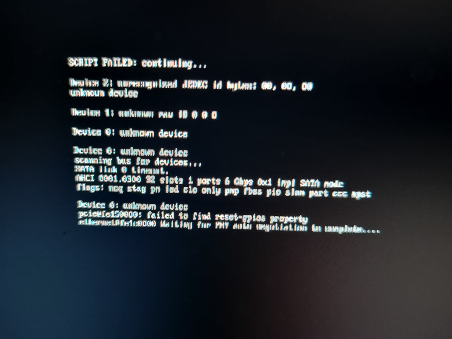

System crashed with following black screen
While using axon through dao.vicharak website, terminatal shows segment fault .
On rebooting I am getting this behaviour
Temp avg :57 c
After getting this, it stuck on u-boot-console. Could you try running the boot command and see whether it fetches the kernel?

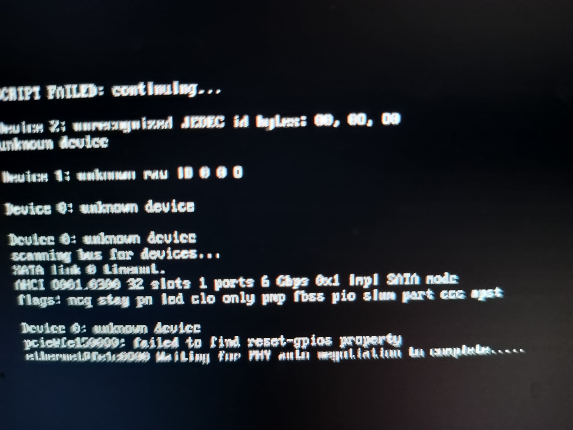

phy@fed80000: mode 0x02 is not support
hdmi@fde80000 disconnected
phy@fed90000: mode 0x02 is not support

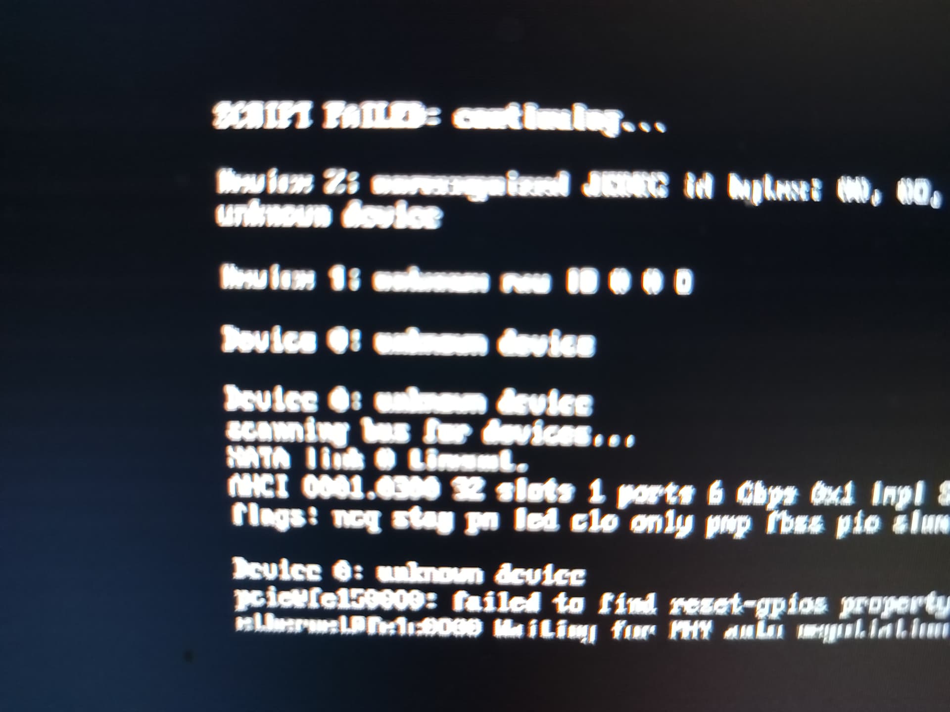

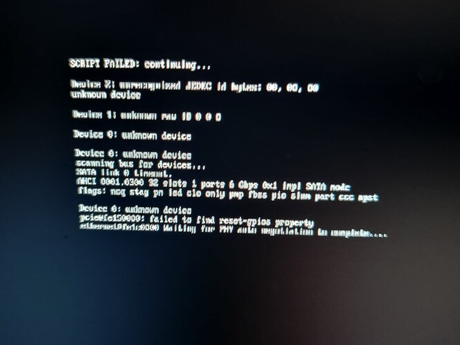

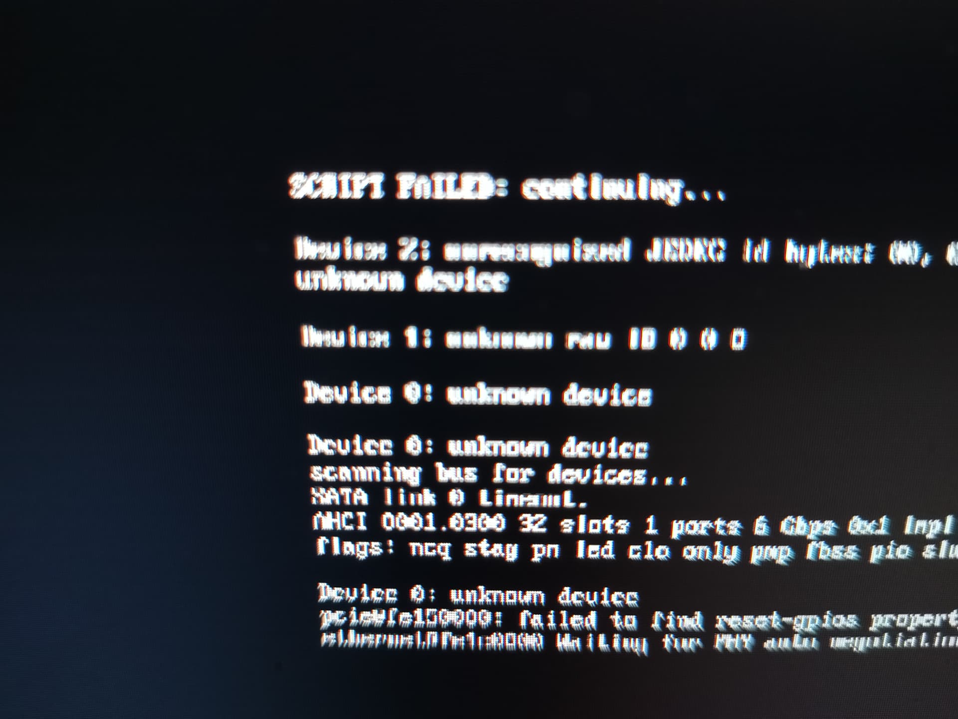

SCRIPT FAILED: continuing…
Device 2: unrecognized JEDEC id bytes: 00, 00, 00
unknown device
Device 1: unknown raw ID 0 0 0
Device 0: unknown device
scanning bus for devices…

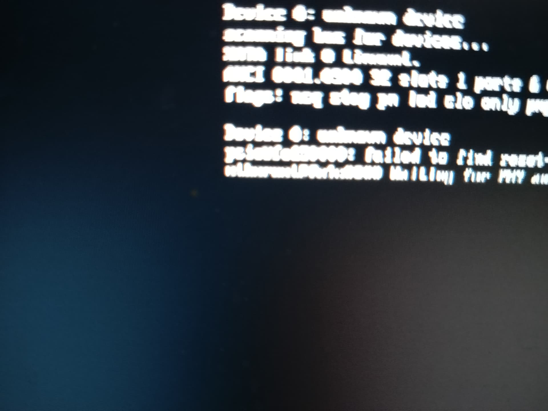

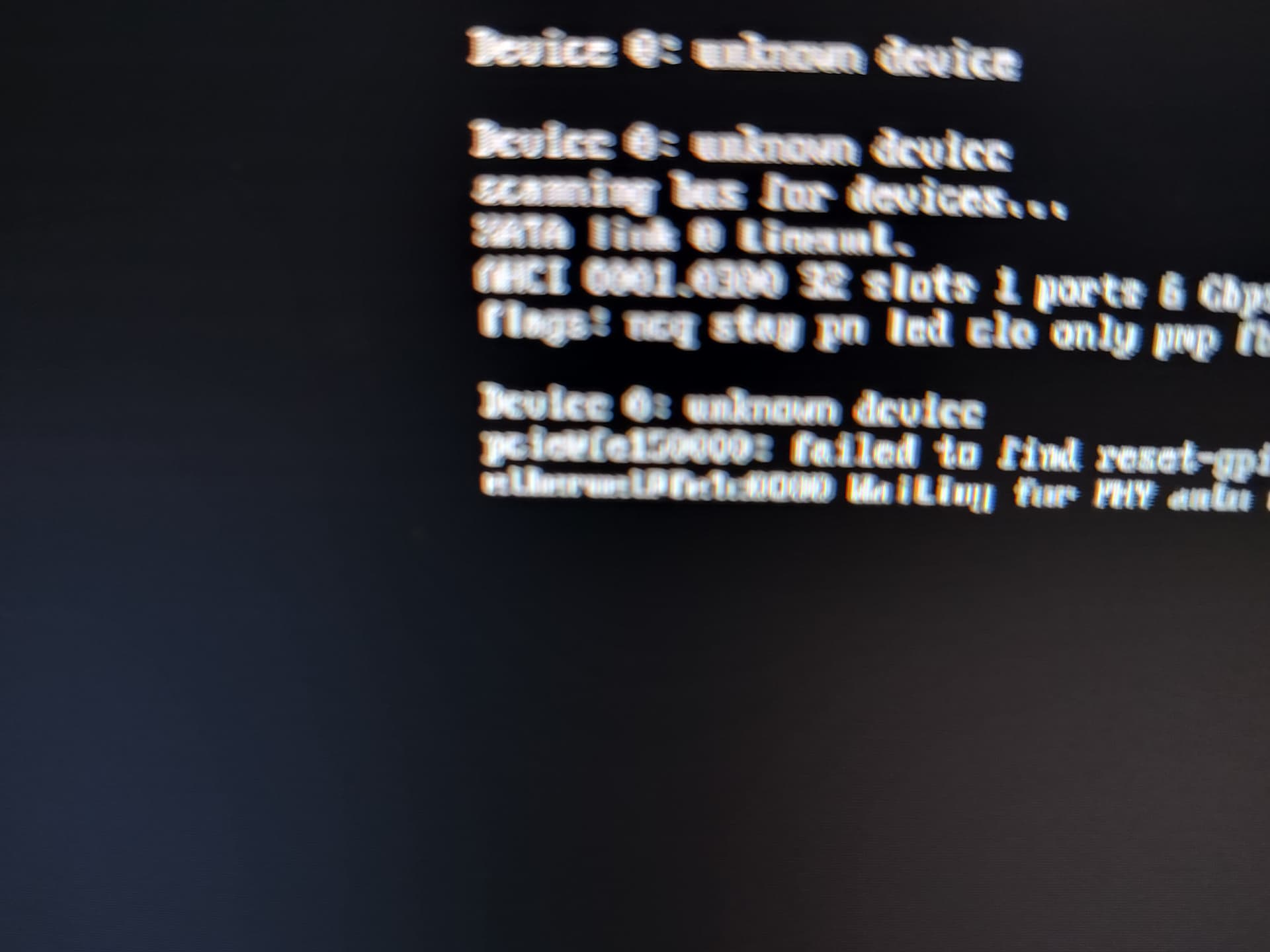

SATA link 0 timeout.
AHCI 0001.0300 32 slots 1 ports 6 Gbps 0x1 impl SATA mode
flags: ncq stag pm led clo only pmp fbss pio slum part ccc apst
pcie@fe150000: failed to find reset-gpios property
ethernet@fe1c0000 Waiting for PHY auto negotiation to complete… TIMEOUT !
phy_startup() failed: -110FAILED: -110missing environment variable: pxeuuid
Retrieving file: /extlinux/pxelinux.cfg/01-0a-e7-d6-85-57-22
phy_startup() failed: -110FAILED: -110Retrieving file: /extlinux/pxelinux.cfg/00000000

CH0 RX Vref:26.7%, TX Vref:19.8%,0.0%
CH1 RX Vref:26.7%, TX Vref:21.8%,0.0%
CH2 RX Vref:26.3%, TX Vref:21.8%,0.0%
CH3 RX Vref:28.5%, TX Vref:19.8%,0.0%
change to F1: 528MHz
change to F2: 1068MHz
change to F3: 1560MHz
DDR 73dffea49e typ 23/09/20-14:18:32,fwver: v1.14
LPDDR4X, 2112MHz
channel[0] BW=16 Col=10 Bk=8 CS0 Row=17 CS=1 Die BW=16 Size=2048MB
channel[1] BW=16 Col=10 Bk=8 CS0 Row=17 CS=1 Die BW=16 Size=2048MB
channel[2] BW=16 Col=10 Bk=8 CS0 Row=17 CS=1 Die BW=16 Size=2048MB
channel[3] BW=16 Col=10 Bk=8 CS0 Row=17 CS=1 Die BW=16 Size=2048MB
Manufacturer ID:0xff
CH0 RX Vref:27.1%, TX Vref:19.8%,0.0%
CH1 RX Vref:26.3%, TX Vref:21.8%,0.0%
CH2 RX Vref:25.4%, TX Vref:21.8%,0.0%
LPDDR4X, 2112MHz
CH2 RX Vref:26.3%, TX Vref:20.8%,0.0%
LPDDR4X, 2112MHz
CH1 RX Vref:26.3%, TX Vref:22.8%,0.0%
CH2 RX Vref:25.8%, TX Vref:21.8%,0.0%
change to F0: 2112MHz
out
U-Boot SPL board init
U-Boot SPL 2017.09-gd1fdcb4853-230928-dirty #dj (Feb 05 2026 - 05:07:53)
Trying to boot from MMC1
SPL: A/B-slot: _a, successful: 0, tries-remain: 7
Trying fit image at 0x4000 sector
Verified-boot: 0
Checking atf-1 0x00040000 … sha256(6f85d1c4de…) + OK
Checking uboot 0x00200000 … sha256(8f5e614d49…) + OK
Checking fdt 0x00366f40 … sha256(7eafe7c645…) + OK
Checking atf-2 0x000f0000 … sha256(aa71013e72…) + OK
Checking atf-3 0xff100000 … sha256(225d6bf071…) + OK
Jumping to U-Boot(0x00200000) via ARM Trusted Firmware(0x00040000)
Total: 76.7/231.315 ms
INFO: Preloader serial: 2
NOTICE: BL31: v2.3():v2.3-652-g24b7dd41a:derrick.huang, fwver: v1.43
NOTICE: BL31: Built : 14:53:32, Sep 26 2023
INFO: spec: 0x1
INFO: ext 32k is not valid
INFO: ddr: stride-en 4CH
INFO: GICv3 without legacy support detected.
INFO: ARM GICv3 driver initialized in EL3
INFO: valid_cpu_msk=0xff bcore0_rst = 0x0, bcore1_rst = 0x0
INFO: l3 cache partition cfg-0
INFO: system boots from cpu-hwid-0
INFO: idle_st=0x21fff, pd_st=0x11fff9, repair_st=0xfff70001
INFO: dfs DDR fsp_params[0].freq_mhz= 2112MHz
INFO: dfs DDR fsp_params[1].freq_mhz= 528MHz
INFO: dfs DDR fsp_params[2].freq_mhz= 1068MHz
INFO: dfs DDR fsp_params[3].freq_mhz= 1560MHz
INFO: BL31: Initialising Exception Handling Framework
INFO: BL31: Initializing runtime services
WARNING: No OPTEE provided by BL2 boot loader, Booting device without OPTEE initialization. SMC`s destined for OPTEE will return SMC_UNK
ERROR: Error initializing runtime service opteed_fast
INFO: BL31: Preparing for EL3 exit to normal world
INFO: Entry point address = 0x200000
INFO: SPSR = 0x3c9
U-Boot 2017.09-gd1fdcb4853-230928-dirty #dj (Feb 05 2026 - 05:07:53 +0000)
Model: Vicharak RK3588 AXON VO.3
MPIDR: 0x81000000
PreSerial: 2, raw, 0xfeb50000
DRAM: 8 GiB
Sysmem: init
Relocation Offset: ed2f7000
Relocation fdt: eb1f9c10 - eb1fecd0
CR: M/C/I
mmc@fe2c0000: 1, mmc@fe2e0000: 0
Bootdev(atags): mmc 0
MMC0: HS400 Enhanced Strobe, 200Mhz
PartType: EFI
DM: v2
=================begin===================
274348 bytes read in 4 ms (65.4 MiB/s)
DTB(Distro): rk3588-axon-linux.dtb
Error binding driver ‘fixed regulator’: -22
Some drivers failed to bind
I2c0 speed: 100000Hz
vsel-gpios- not found!
en-gpios- not found!
vdd_cpu_big0_s0 800000 uV
vdd_cpu_big1_s0 800000 uV
I2c1 speed: 400000Hz
vdd_npu_s0 800000 uV
spi2: RK806: 2
ON=0x40, OFF=0x00
vdd_gpu_s0 750000 uV
vdd_cpu_lit_s0 750000 uV
vdd_log_s0 750000 uV
vdd_vdenc_s0 init 750000 uV
vdd_ddr_s0 850000 uV
I2c6 speed: 400000Hz
Device ‘gpio@fd8a0000’: seq 0 is in use by ‘gpio@fd8a0000’
Device ‘i2c@fec80000’: seq 6 is in use by ‘i2c@fec80000’
I2c6 speed: 100000Hz
*** Warning - bad CRC, using default environment
get vp0 plane mask:0x5, primary id:0, cursor_plane:2, from dts
get vp1 plane mask:0xa, primary id:1, cursor_plane:3, from dts
get vp2 plane mask:0x140, primary id:6, cursor_plane:8, from dts
get vp3 plane mask:0x280, primary id:7, cursor_plane:9, from dts
Device ‘gpio@fec20000’: seq 1 is in use by ‘gpio@fd8a0000’
Could not find baseparameter partition
Model: Vicharak RK3588 AXON VO.3 LINUX
MPIDR: 0x81000000
boot mode: None
No resource file: logo.bmp
512 bytes read in 21 ms (23.4 KiB/s)
rockchip_read_distro_logo: Load logo.bmp from 0:3
188054 bytes read in 22 ms (8.2 MiB/s)
Rockchip UBOOT DRM driver version: v1.0.1
vp0 have layer nr:2[0 2 ], primary plane: 0
vp1 have layer nr:2[1 3 ], primary plane: 1
vp2 have layer nr:2[6 8 ], primary plane: 6
vp3 have layer nr:2[7 9 ], primary plane: 7
CLK: (sync kernel. arm: enter 1008000 KHz, init 1008000 KHz, kernel 0N/A)
b0pll 24000 KHz
b1pll 24000 KHz
lpll 24000 KHz
v0pll 24000 KHz
aupll 786431 KHz
cpll 1500000 KHz
gpll 1188000 KHz
npll 850000 KHz
ppll 1100000 KHz
aclk_center_root 702000 KHz
pclk_center_root 100000 KHz
hclk_center_root 396000 KHz
aclk_center_low_root 500000 KHz
aclk_top_root 750000 KHz
pclk_top_root 100000 KHz
aclk_low_top_root 396000 KHz
Debug: buf[0] = 0x00, expected = 0x80
U-Boot console: ENABLED
Net: eth1: ethernet@fe1c0000
starting USB…
Bus usb@fc000000: usb maximum-speed not found
Register 2000140 NbrPorts 2
Starting the controller
USB XHCI 1.10
Bus usb@fc800000: USB EHCI 1.00
Bus usb@fc840000: USB OHCI 1.0
Bus usb@fc880000: USB EHCI 1.00
Bus usb@fc8c0000: USB OHCI 1.0
Bus usb@fcd00000: usb maximum-speed not found
LPDDR4X, 2112MHz
LPDDR4X, 2112MHz
CH0 RX Vref:26.7%, TX Vref:20.8%,0.0%
CH1 RX Vref:26.7%, TX Vref:22.8%,0.0%
CH3 RX Vref:28.9%, TX Vref:19.8%,0.0%
out
Verified-boot: 0
Total: 75.780/231.766 ms
INFO: spec: 0x1
INFO: SPSR = 0x3c9
MPIDR: 0x81000000
DRAM: 8 GiB
Sysmem: init
CR: M/C/I
PartType: EFI
DM: v2
274348 bytes read in 3 ms (87.2 MiB/s)
spi2: RK806: 2
ON=0x40, OFF=0x00
MPIDR: 0x81000000
boot mode: None
512 bytes read in 20 ms (24.4 KiB/s)
188054 bytes read in 21 ms (8.5 MiB/s)
b0pll 24000 KHz
b1pll 24000 KHz
lpll 24000 KHz
v0pll 24000 KHz
aupll 786431 KHz
cpll 1500000 KHz
gpll 1188000 KHz
npll 850000 KHz
ppll 1100000 KHz
starting USB…
USB XHCI 1.10
USB XHCI 1.10
Bus usb@fc400000: usb maximum-speed not found
USB XHCI 1.10
scanning bus usb@fc000000 for devices… 1 USB Device(s) found
scanning bus usb@fc800000 for devices… 1 USB Device(s) found
scanning bus usb@fc840000 for devices… 1 USB Device(s) found

pcie@fe150000: PCIe-0 Link Fail
MMC: no card present
mmc_init: -123, time 14 card not detected!
switch to partitions #0, OK
mmc0(part 0) is current device
Scanning mmc 0:3…
Found /extlinux/extlinux.conf
Retrieving file: /extlinux/extlinux.conf
828 bytes read in 25 ms (32.2 KiB/s)
unknown device
Axon.log.txt (33.0 KB)
@Avi_Shihora
This is output from TTL .
Flashed Memory Card . I am able to boot it now .

[ 24.539463] debugfs: Directory ‘fdab0000.npu-rknpu’ with parent ‘vdd_npu_s0’ already present!
[ 25.875782] rk_hdmirx fdee0000.hdmirx-controller: hdmirx_cancel_cpu_limit_freq freq qos nod add
[ 26.640483] rk-pcie fe170000.pcie: PCIe Link Fail, LTSSM is 0x3, hw_retries=0
[ 26.652507] rk-pcie fe180000.pcie: PCIe Link Fail, LTSSM is 0x3, hw_retries=0
[ 26.656439] rk-pcie fe150000.pcie: PCIe Link Fail, LTSSM is 0x0, hw_retries=0
[ 26.656483] rk-pcie fe150000.pcie: failed to initialize host
[ 27.599845] systemd[1]: Failed to find module ‘autofs4’
[ 30.748408] rk-pcie fe180000.pcie: PCIe Link Fail, LTSSM is 0x3, hw_retries=1
[ 30.748481] rk-pcie fe170000.pcie: PCIe Link Fail, LTSSM is 0x3, hw_retries=1
[ 31.756413] rk-pcie fe170000.pcie: failed to initialize host
[ 31.756491] rk-pcie fe180000.pcie: failed to initialize host
[ 33.550981] of_dma_request_slave_channel: dma-names property of node ‘/serial@febc0000’ missing or empty
[FAILED] Failed to start usbdevice.service - Manage USB device functions.
Ubuntu 24.04.3 LTS vicharak ttyFIQ0
vicharak login: user
Password:
Login incorrect
Password:
Login incorrect
vicharak login: [ 70.696338] Bluetooth: hci0: Opcode 0x0c52 failed: -110
[ 70.696451] Bluetooth: hci0: command 0x0c52 tx timeout
[ 71.783557] Bluetooth: Peer acked invalid packet
Password:
Login timed out after 60 seconds.
vicharak login: vicharak
Password:
Welcome to Ubuntu 24.04.3 LTS (GNU/Linux 6.1.75-axon aarch64)
m m " # #
“m m” mmm mmm # mm mmm m mm mmm # m
# # #" " #" # " # #" " " # # m"

vicharak@vicharak:~$ uname -a\
Genuine issue is, your eMMC extlinux.conf file corrupted/misconfigured.
Can this issue be resolved using TTL device?
You use ums command on tty device.
Axon Board USB Mass Storage (UMS) Setup Guide
Prerequisites
  • Operating System: Linux host system
  • Hardware: USB Type-C to USB Type-A (or Type-C to Type-C) cable
  • Device: Axon board
Step-by-Step Instructions
Step 1: Connect the Hardware
Connect one end of the USB cable to the Axon Type-C0 port and the other end to an available USB port on your Linux host system.
Step 2: Interrupt the Boot Process
Power on or reboot the Axon board. While the device is booting up, repeatedly press Ctrl + C in your serial terminal session to interrupt the auto-boot sequence and access the bootloader prompt (=>).
Step 3: Enable USB Mass Storage (UMS)
At the bootloader command prompt, run the following command to expose the onboard MMC storage over USB:
ums 0 mmc 0
Step 4: Verify Partitions on Host
Open a terminal on your Linux host system and verify that the drive has been exposed properly by checking block devices:
Bash
lsblk
You should see the newly attached Axon storage device displayed with 8 partitions.
Now, you can check it out partition 4.
Mount /dev/sdX4 in linux system device.
X=1,2 etc., according to connected block devices in your linux system
sudo mount /dev/sdX4 /mnt
You can see extlinux.conf file in extlinux folder.
