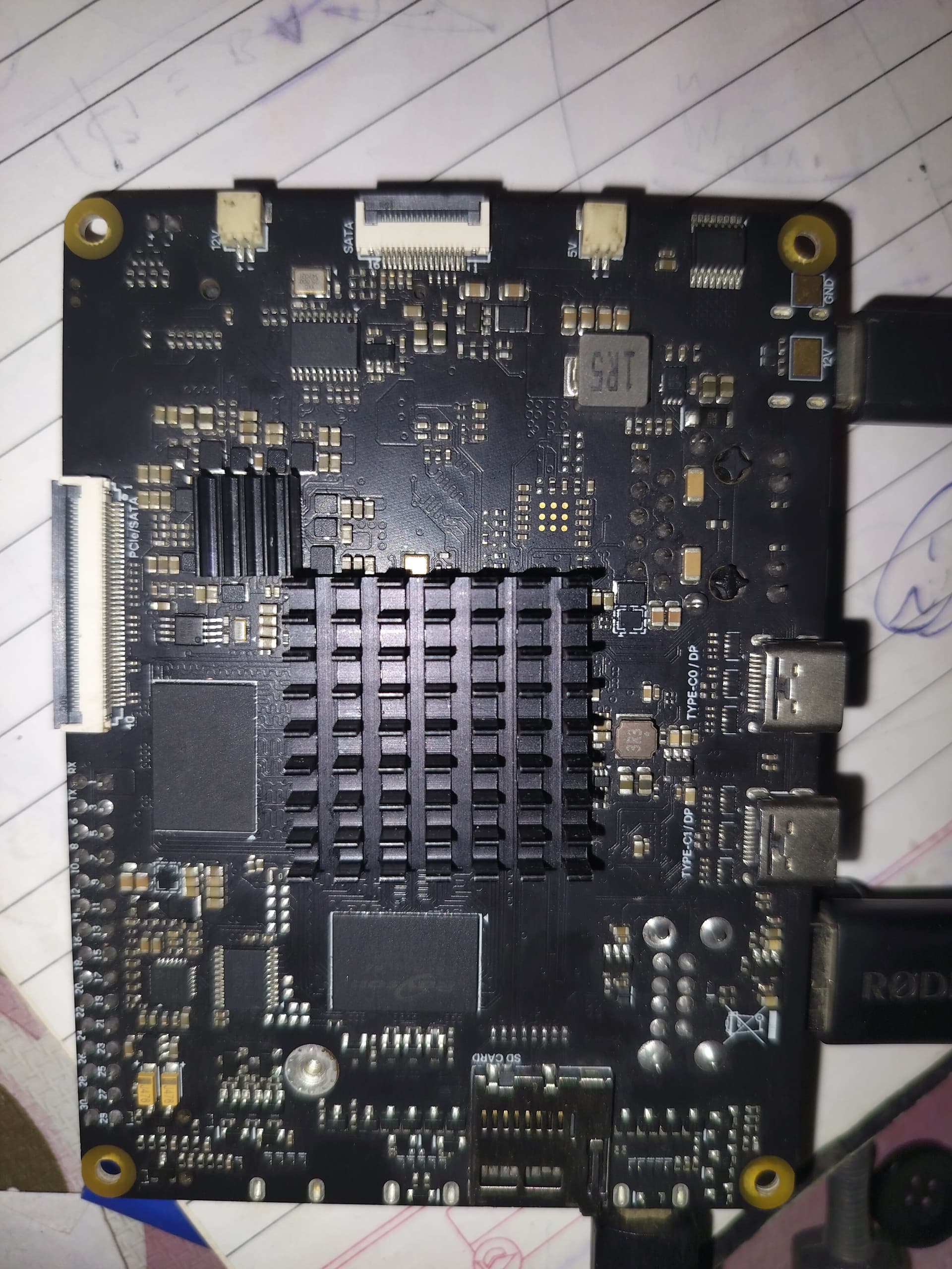

So my Axon is working, BUT NOT FINE.
The system is heating up too much after being used for some minutes.

Can you show us the temps?
Do you have heat sink attached to the board?
Temperature
cat /sys/class/thermal/thermal_zone*/temp
49000
49000
49000
49923
49000
49000
49000
stress-ng --cpu 4
stress-ng: info:  [36881] defaulting to a 1 day, 0 secs run per stressor
stress-ng: info:  [36881] dispatching hogs: 4 cpu
82230
84076
84076
82230
80384
79461
80384
73000
73000
73923
73000
73000
73000
73000
@djkabutar
It is reaching 83 C, you can attach external active fan.
