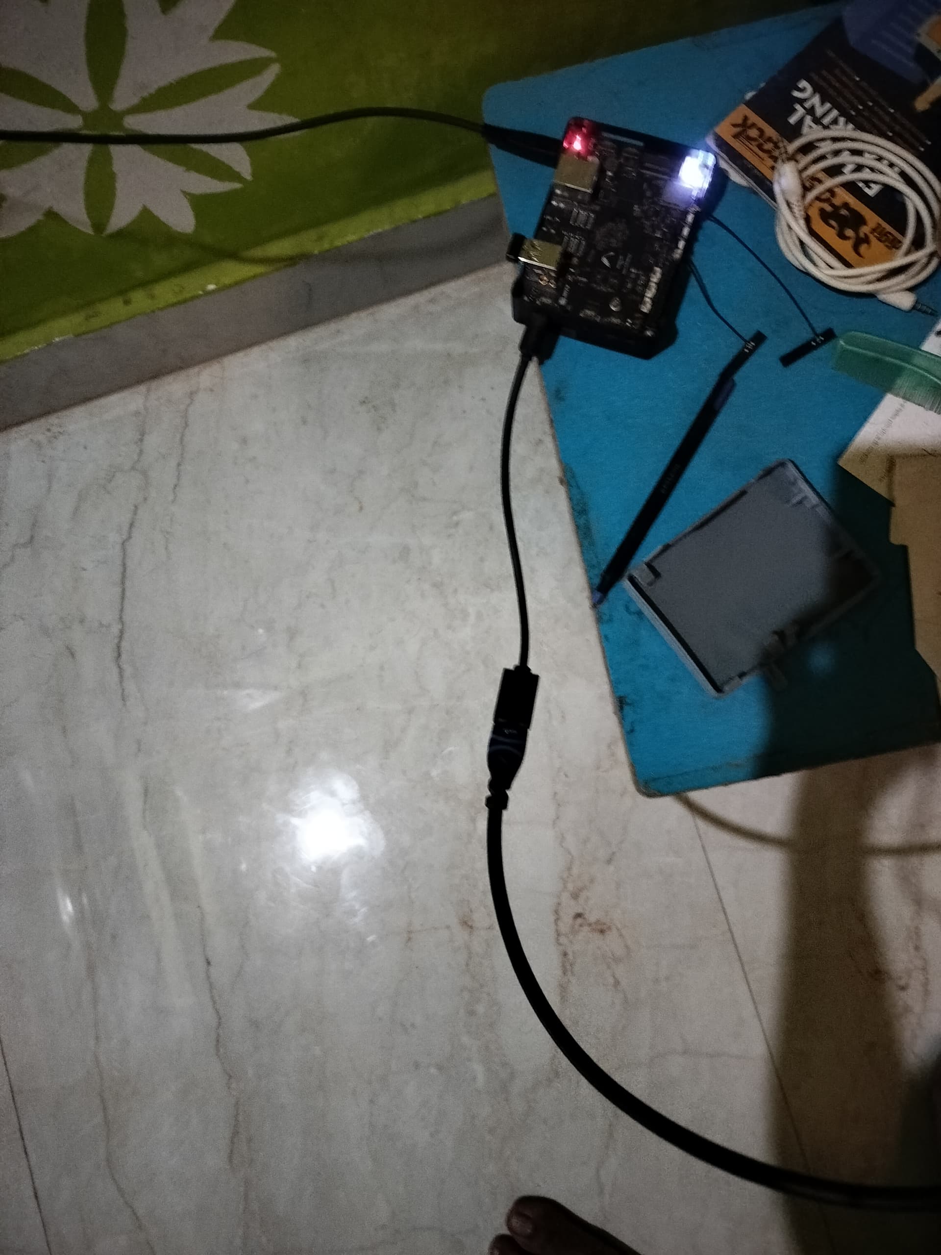

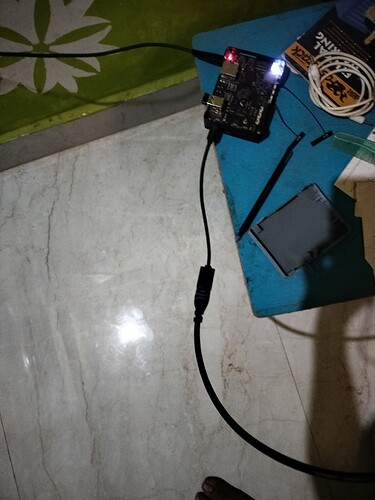

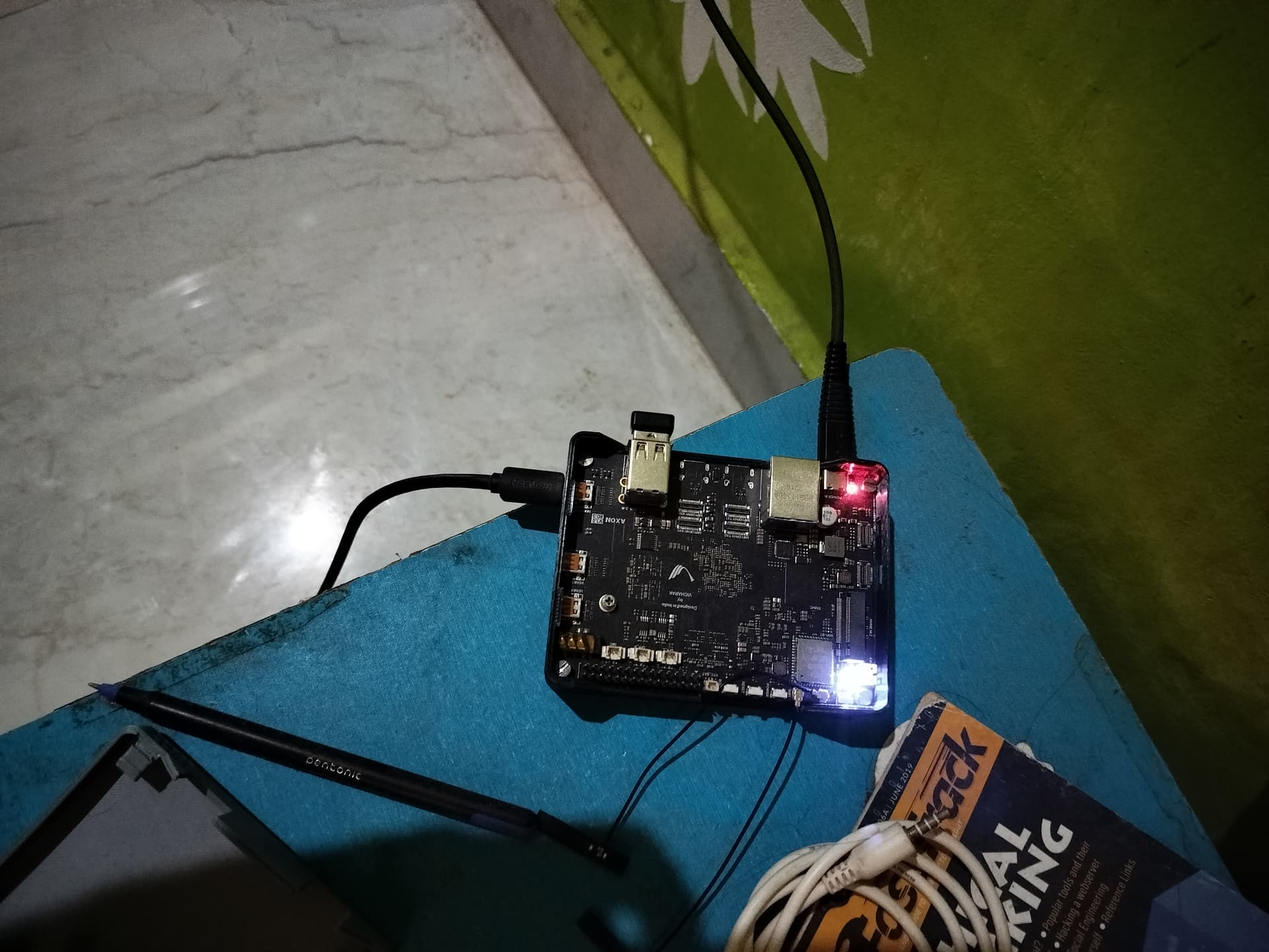

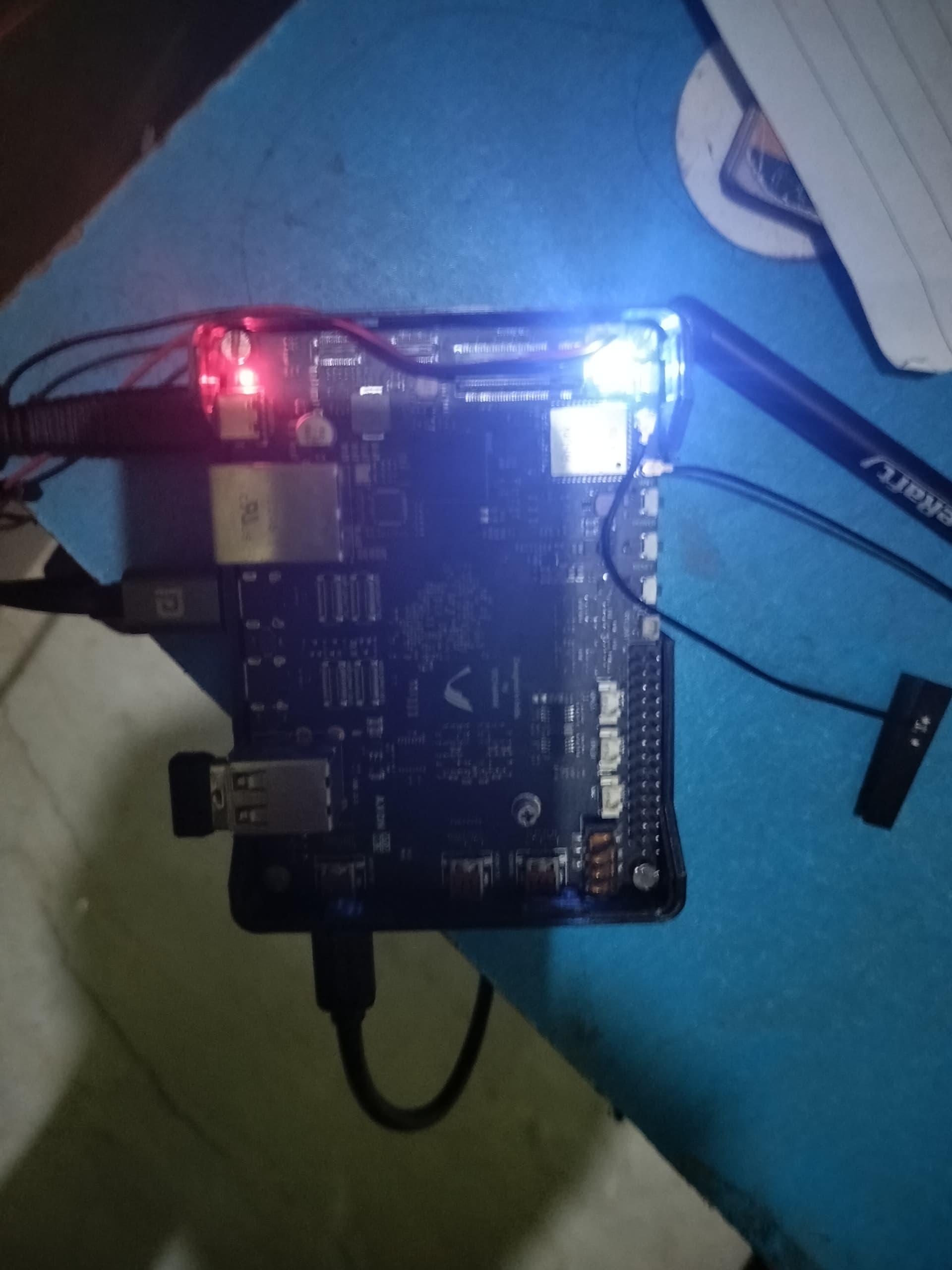

Using Docker causes multiple system crash and eventually Fails to Boot
So I am using Docker to build ARM64 applications natively on the Axon system.
To save space I am storing the cache in an SD card, a SanDisk Extreme 64GB U3 A2 microXC V30.
The system was working fine for a while, then it started to crash after some time whenever Docker.service started .
I thought it was due to high RAM usage, so I avoided using the browser while running the Docker.
The crashes become frequent. Now the system is not working at all .
The white light stays still, It’s not blinking.
I also tried to reflash the image, but that approch also not working , alas i am getting a segmentation error .
